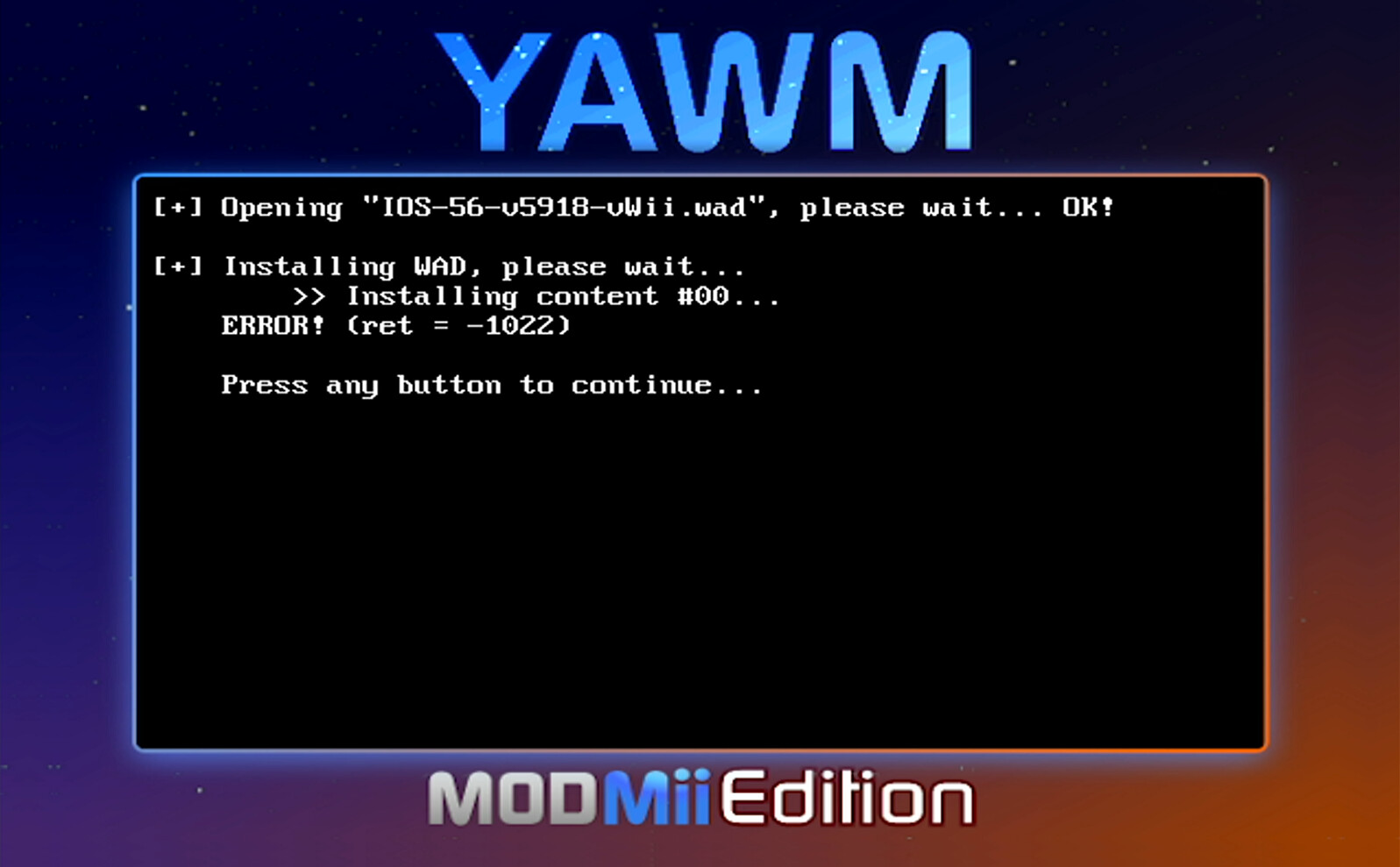

it gives me this error
Oops, I missed something. In NUSGet, you need to tick the Re-encrypt title using the Wii Common Key box. If you do that and redownload, then copy over the new WAD, it should work.
Sorry for the confusion!
It works now. Thank you!
